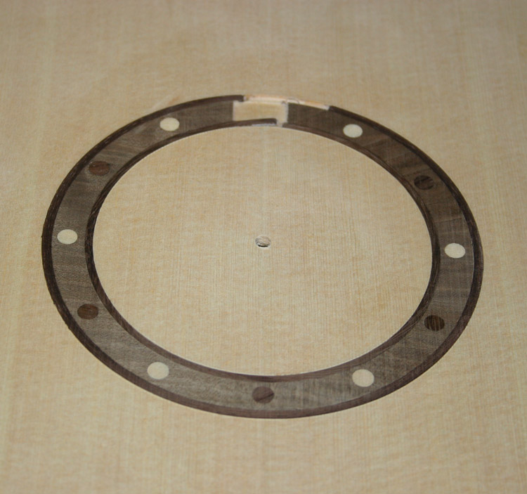

I use a 6mm Veritas plug cutter it works a charm, this is one I am working on at the moment.

[QUOTE=RussellR] I use a 6mm Veritas plug cutter it works a charm, this is one I am working on at the moment.
Details please Russell. Walnut/rosewood?
PostPosted: Sat Jul 22, 2006 10:24 pm
Hi Colin
The Center Ring is Walnut, with Madrose and spruce dots, and Madrose around the outside.
This is for guitar I was after the Madrose Binding for, the body of it will be Walnut, the Top is Lutz Spruce.
